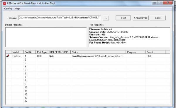

Ola,amigo apague esta linha:
Veja um exemplo
<?xml version="1.0" encoding="utf-8"?>
<flashing>
<header>
<phone_model model="Scorpion Mini I LATAM"/>
<software_version version="smi_latam-user 4.0.4 8.7.1I-110_SML-20 1352240066 release-keysSUNRISE_SMB_REV30_V2_R3_1233.C9"/>
<interfaces>
<interface name="AP"/>
</interfaces>
</header>
<steps interface="AP">
<step operation="getvar" var="max-download-size" />
<step operation="flash" partition="gpt" filename="gpt_signed" MD5="41ba4d961f96655c1fd25908a05151e8"/>
<step operation="oem" var="fb_mode_set"/>
<step operation="flash" partition="motoboot" filename="motoboot" MD5="405029619219aa3011a7a86653c5236e"/>
<step operation="flash" partition="boot" filename="boot_signed" MD5="bf6af636111e421a325bcbf7987e4f2b"/>
<step operation="flash" partition="recovery" filename="recovery_signed" MD5="177d2a50e9b5a485616dfe4853845286"/>
<step operation="flash" partition="radio" filename="radio_signed" MD5="c50f577ea26a1c414bb76ff2c98aaa85"/>
<step operation="flash" partition="system" filename="system_signed" MD5="8aa5e437895465b64ab9fdc6e2f357e2"/>
<step operation="flash" partition="cdrom" filename="cdrom_signed" MD5="0bdf3e77c2027d7f8e9264e66a7ae31a"/>
<step operation="erase" partition="cache"/>
<step operation="erase" partition="userdata"/>
<step operation="oem" var="fb_mode_clear"/>
</steps>
</flashing>
no arquivo do bloco de notas apague esse trecho (so o q esta em vermelho)
