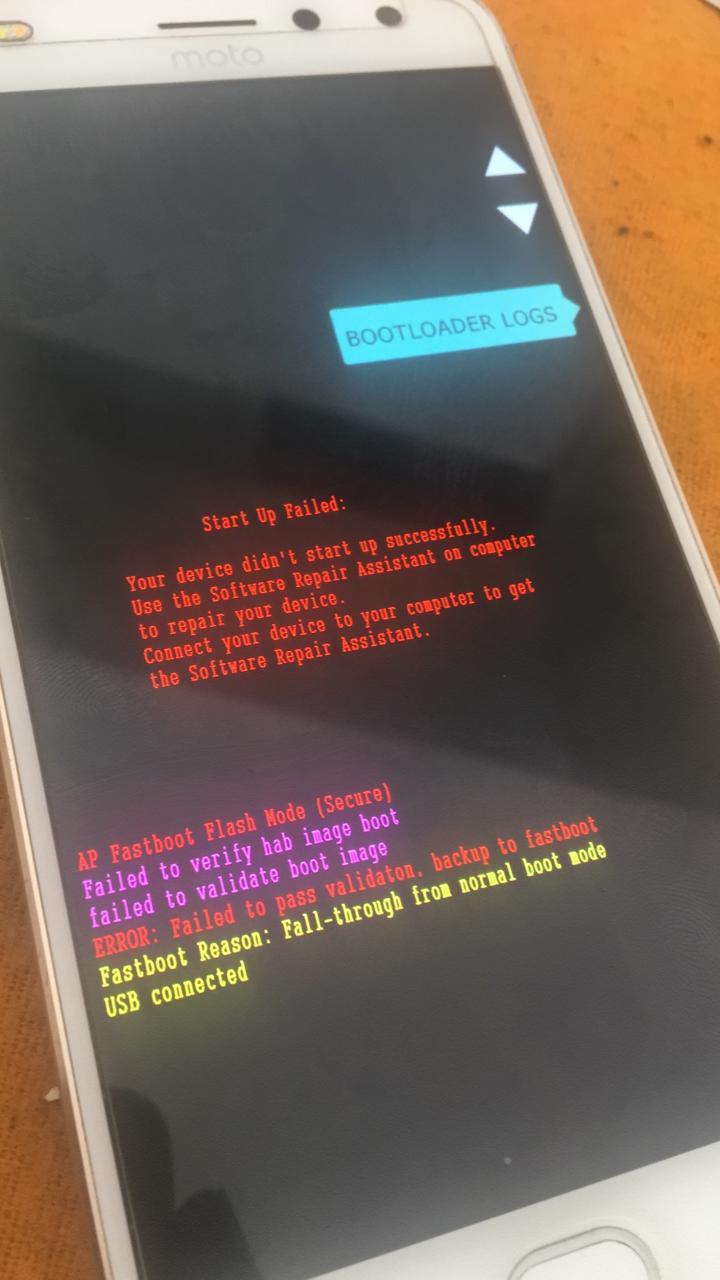

Boa tarde, estou com um z2 play xt1710-07 o cliente disse que esta no whats app, quando o mesmo reiniciou e ficou na logo moto, depois ele caiu na tela de fastboot, ja fiz a flash da ultima versão clansoft disponivel, tambem fiz pelo assistente lenovo, o mesmo passa normal porem não inicializa, obs: passei a flash pela umt, o mesmo não escreve a partição gpt.bin sempre da erro Sending Data [partition]... Error[2], porem se eu desmarcar essa opção ele passa normal, mais tambem não funciona.
Informações do aparelho.
(bootloader) version: 0.5
(bootloader) version-bootloader: moto-msm8953-C0.CD
(bootloader) product: albus
(bootloader) board: albus
(bootloader) secure: yes
(bootloader) hwrev: P4
(bootloader) radio: 5
(bootloader) storage-type: emmc
(bootloader) emmc: 64GB SKHYNIX HCG8a4 RV=08 PV=A2 FV=00000000000000A2
(bootloader) ram: 4GB SKHYNIX LP3 DIE=8Gb M5=06 M6=03 M7=00 M8=5F
(bootloader) cpu: MSM8953
(bootloader) serialno: 0039617193
(bootloader) cid: 0x0032
(bootloader) channelid: 0x19
(bootloader) uid: 5EF470DB00000000000000000000
(bootloader) securestate: oem_locked
(bootloader) iswarrantyvoid: no
(bootloader) max-download-size: 534773760
(bootloader) reason: Fall-through from normal boot mode
(bootloader) imei: 35564XXXXX87930
(bootloader) meid:
(bootloader) date: 10-20-2017
(bootloader) sku: XT1710-07
(bootloader) carrier_sku:
(bootloader) battid: SNN5983B
(bootloader) iccid:
(bootloader) cust_md5:
(bootloader) max-sparse-size: 268435456
(bootloader) current-time:
(bootloader) ro.build.fingerprint[0]: motorola/albus/albus:8.0.0/OPSS27.
(bootloader) ro.build.fingerprint[1]: 76-12-25-23/22:user/release-keys
(bootloader) poweroffalarm: 0
(bootloader) ro.build.version.full[0]: Blur_Version.27.451.22.albus.reta
(bootloader) ro.build.version.full[1]: il.en.US
(bootloader) ro.build.version.qcom: LA.UM.6.6.r1-04400-89xx.0
(bootloader) version-baseband: M8953P_50.59.07.96R ALBUS_BRAZILDSDS_CUST
(bootloader) kernel.version[0]: Linux version 3.18.71-perf-g5ae32b7 (hud
(bootloader) kernel.version[1]: soncm@ilclbld31) (gcc version 4.9.x 2015
(bootloader) kernel.version[2]: 0123 (prerelease) (GCC) ) #1 SMP PREEMPT
(bootloader) kernel.version[3]:  Mon Jun 10 02:12:58 CDT 2019
(bootloader) sbl1.git: git=MBM-NG-VC0.CD-0-g4650d8f
(bootloader) rpm.git: git=MBM-NG-VC1.82-0-gbd19194
(bootloader) tz.git: git=72ed912-dirty
(bootloader) devcfg.git: git=72ed912-dirty
(bootloader) keymaster.git: git=72ed912-dirty
(bootloader) cmnlib.git: git=72ed912-dirty
(bootloader) cmnlib64.git: git=72ed912-dirty
(bootloader) prov.git: git=72ed912-dirty
(bootloader) aboot.git: git=MBM-NG-VC0.CD-0-g361b83a
(bootloader) frp-state: protected (77)
(bootloader) ro.carrier: retbr
(bootloader) current-slot:
(bootloader) slot-suffixes: _a
(bootloader) slot-count: 1
(bootloader) slot-successful:_a: INVALID
(bootloader) slot-successful:_b: INVALID
(bootloader) slot-bootable:_a: INVALID
(bootloader) slot-bootable:_b: INVALID
(bootloader) slot-retry-count:_a: unknown
(bootloader) slot-retry-count:_b: unknown

bom dia amigo , tente passar pelo scrip porém a umt ultimamente tá dando varios erros ao escrever flash dos motorolas.
