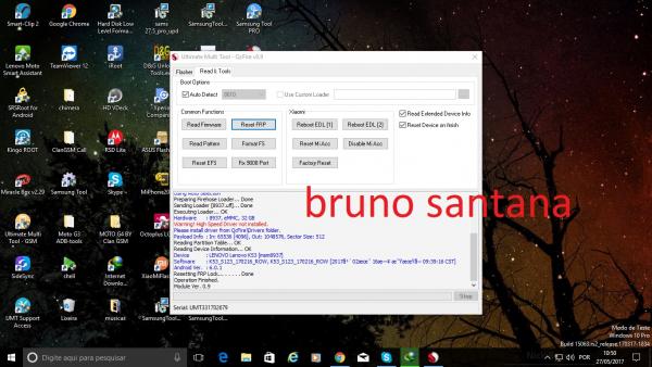

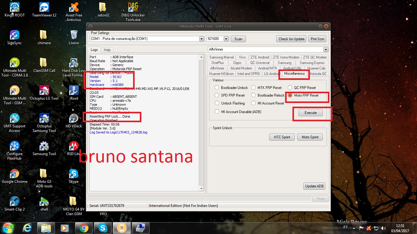

    reset frp moto g4 android 7.0 100%
  • Bruno Santana

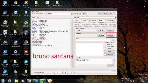

    Bruno Santana
    reset frp j320m 100%
