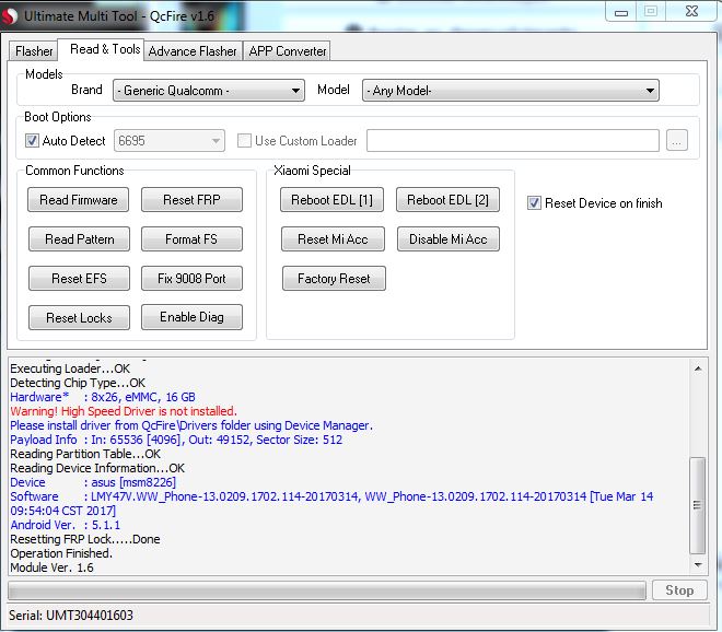

FRP ASUS ZB551KL feito por modo EDL
Operation    : Reset FRP
Checking for existing devices...Found
Port    : COM312
Opening Port...OK
Init Handshake Sequence...OK
Hardware ID    : E1809100 [8x10] 00000000
OPK_DATA    : 9CBA94693C2333A562BCF0E0E981C558748817D002F543B2A26AB1B4B3F1CF9E
Initializing Protocol...OK
Using Auto Loader Selection [4]
No compatible loader found. Device may not boot with this loader.
Preparing Firehose Loader...Done
Sending Loader [8x10.ufl]...Done
Executing Loader...OK
Detecting Chip Type...OK
Hardware*    : 8x26, eMMC, 16 GB
Warning! High Speed Driver is not installed.
Please install driver from QcFire\Drivers folder using Device Manager.
Payload Info    : In: 65536 [4096], Out: 49152, Sector Size: 512
Reading Partition Table...OK
Reading Device Information...OK
Device    : asus [msm8226]
Software    : LMY47V.WW_Phone-13.0209.1702.114-20170314, WW_Phone-13.0209.1702.114-20170314 [Tue Mar 14 09:54:04 CST 2017]
Android Ver.    : 5.1.1
Resetting FRP Lock.....Done
Operation Finished.
Module Ver. 1.6

Module Ver. 1.71.thumb.jpg.e09994e64c67d69eb8c0a8761b3d896a.jpg2.thumb.jpg.6ccc24e672f74456073dbf19cece4774.jpg

OPK_DATA    : 079E496E26A477B120DFCD85DF7E4AD067164D8292DDD379930D5891E3D8240B
Using Auto Loader Selection [1]
Sending Loader [8937.ufl]...Done
Hardware    : 8937, eMMC, 32 GB
LU Count    : 1 [0x03A3E000]
WARNING! High Speed Driver is not installed.
Payload Info    : In: 65536 [4096], Out: 1048576, Sector Size: 512
Device    : Xiaomi Redmi 3S [msm8937]
Software    : MMB29M, V8.5.4.0.MALMIED [Wed Sep 13 11:27:21 WIB 2017]
Android Ver.    : 6.0.1
Patch Level    : 2017-04-01
Resetting Mi Account Data...Done
When phone is completely ON, connect to Internet and add Mi Account.
Operation Finished.
Reset Frp Zenfone 4 Max X00ID
Port    : Qualcomm HS-USB QDLoader 9008 (COM77)
Driver Info    : Qualcomm Incorporated, qcusbser.sys, 2.1.2.2
Opening Port...OK
Hardware ID    : E1600500 [8917] 00000000
OPK_DATA    : 195B400B367642F4CF4C418D86A4E5DF32466A4DD10562790AEF7CEE900E2B8E
Sending Loader [8917_007.ufl]...Done
Hardware    : 8917, eMMC, 16 GB
LU Count    : 1 [0x01D1F000]
Device    : asus ASUS_X00ID [msm8937]
Software    : NMF26F.WW_Phone-14.2016.1803.232-20180301, WW_Phone-14.2016.1803.232-20180301 [Thu Mar  1 23:50:00 CST 2018]
Android Ver.    : 7.1.1
Patch Level    : 2018-03-01
Resetting FRP Lock......Done
Operation Finished.
Module Ver. 2.0
Remoção conta "frp" Xiaomi Redmi Note 4
Device    : Xiaomi Redmi Note 4
Port    : Qualcomm HS-USB QDLoader 9008 (COM32)
Driver Info    : Lenovo Inc., leusbser.sys, 2.0.9.6
Opening Port...OK
Hardware ID    : E1600400 [8953] 00000000
Sending Loader [8953.ufl]...Done
Hardware    : 8953, eMMC, 32 GB
Device    : Xiaomi Redmi Note 4 [msm8953]
Software    : AL1512-mido-build-20180309002948, V9.5.4.0.NCFMIFA [Fri Mar  9 00:29:46 WIB 2018]
Android Ver.    : 7.0
Patch Level    : 2018-02-01
Operation Finished.
Module Ver. 2.1
Remoção conta FRP ASUS ZE552KL Android 8 .
Device    : ASUS ZE552KL
Opening Port...OK
Hardware ID    : E1600400 [8953] 21002900
Sending Loader [8953_010.ufl]...Done
Hardware    : 8953, eMMC, 64 GB
LU Count    : 1 [0x0747C000]
Device    : asus ASUS_Z012D [msm8953]
Software    : OPR1.170623.026.WW_Phone-15.0410.1802.44-0, WW_Phone-15.0410.1802.44-0 [Mon Feb 26 13:38:39 CST 2018]
Android Ver.    : 8.0.0
Operation Finished.
Module Ver. 2.1
