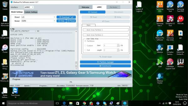

D295F Não dando erro reparo pela medusa pro
preciso da ajuda de você aqui esta dando erro 012 ao rentar reparar o boot pela medusa na primeira vez deu certo deu um erro no final agora ela esta dando esse erro 012 e não finaliza o procedimento oque devo fazer?

Pessoal, minha Medusa Pro acabou de chegar e ainda nao consegui usar, estou com um D295f que esta dando Qualcom usb, ma fiz as soldas do EMMC, e so consigo o seguinte erro:
Model Settings:
Interface : eMMC
Brand : LG
Model : D295
SRF : C:/Program Files (x86)/Medusa Pro Software/firmwareFolder/LG_D295.srf
Voltage : 1.8V
Bus Mode : 1
Bus speed : Auto
Connecting...
Device : Hynix eMMC H4G1d
Page size : 512 B
Block size : 512 B
Block count : 4294967295
CID Info
CID : 90014A4834473164040502A242ADB183
Manufacturer ID : 0X90
Device/BGA : BGA(Discrete embeded)
OEM/Application ID : 0X4A
Product name : H4G1d
Product revision : 0.5
Product serial number : (hex)2A242AD
Manufacturing date : 11/2014
CSD Info
CSD : D02701320F5903FFFFFFFFEF8A4040D3
CSD structure :
SPEC version : 4.1, 4.2, 4.3, 4.4, 4.41, 4.5,
4.51, 5.0, 5.01, 5.1
Data read access time1: 15 ms
TRAN speed : 26 MHz
READ block length : 512 Bytes
WP group enable : YES
PERM_WRITE_PROTECT : NO
TMP_WRITE_PROTECT : NO
EXTCSD Info
Erase block size : 130560 Kbytes
Boot1 size : 32640 Kbytes
Boot2 size : 32640 Kbytes
RPMB size : 32640 Kbytes
Boot partition enable : User area
Partition config : 11111111
Backup EXT_CSD saved to file C:/Program Files (x86)/Medusa Pro Software/EXT_CSD Backups/H4G1d_21_12_2016_13_40_43.bin.
Connect successful.
SW: 1.2.8; FW: 1.14.
Erasing. Please wait... error!
ERROR[013]: Erase error.
Attempting to erase...
error!
Reapairing from file "C:/Program Files (x86)/Medusa Pro Software/firmwareFolder/LG_D295.srf".
Writting GPT partition...
Write verification error 1. Possible reasons: damaged or write protected eMMC.
Disconnected.
Alguem ai conseguiu resolver...?

Modelo errado amigo ! D295f tem a imagem de boot diferente do modelo D295
