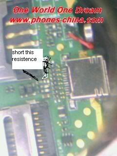

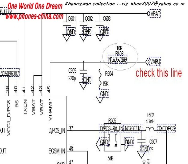

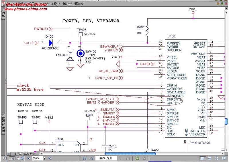

    solução para carregador nokia original não aceito pelos atc´s chineses por possuir uma voltagem um pouco maior que a suportada pelo atc.

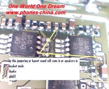

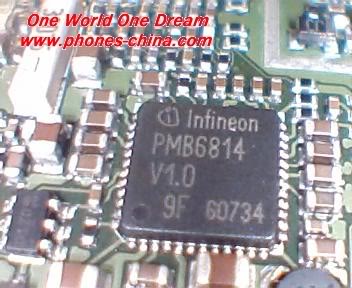

f88headset
sigmatel f88 headset mode new sol
this ic contains the speaker tracks.i think that changing of 5this ic will remove headset mode.
NOTE:Try at ur own risk i never tried this because i don't have the same ic.i seen many members posting again -2 for this problem.

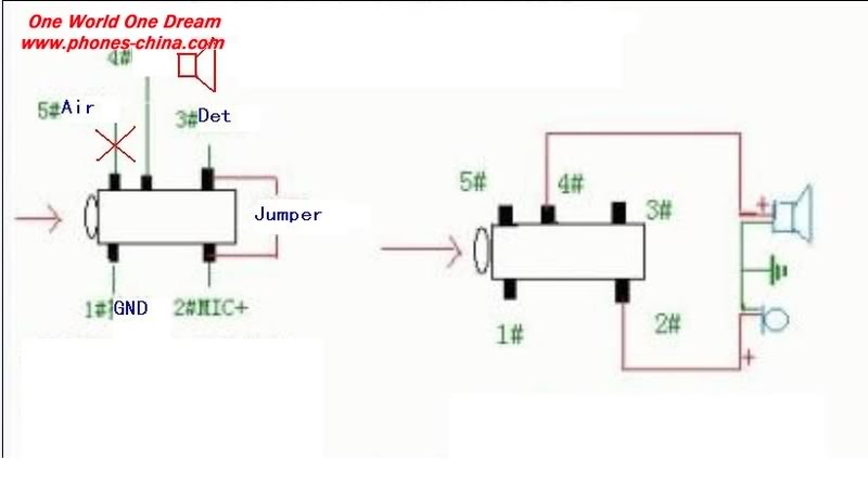

sigmatel s3 head phone slution

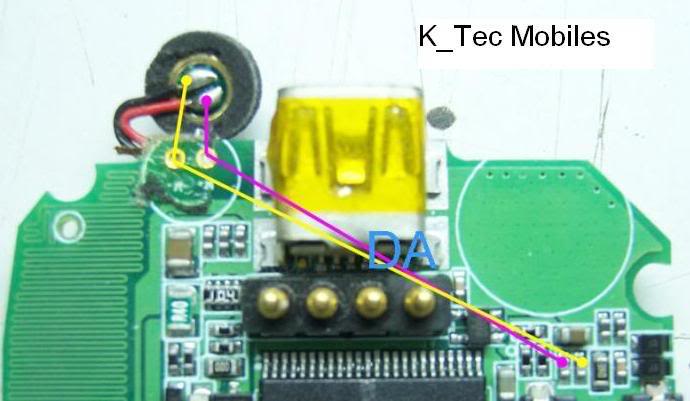

sigmatel s3 headset solution 100%working
this prob comes when inserted a wrong charger in the set
a pin seen below comes from cpu for headset when a wrong charger is inserted then then this pin totaly short now the solution is that remove this pin shorting or
1.change cpu with other and reflash phone with origional flash
