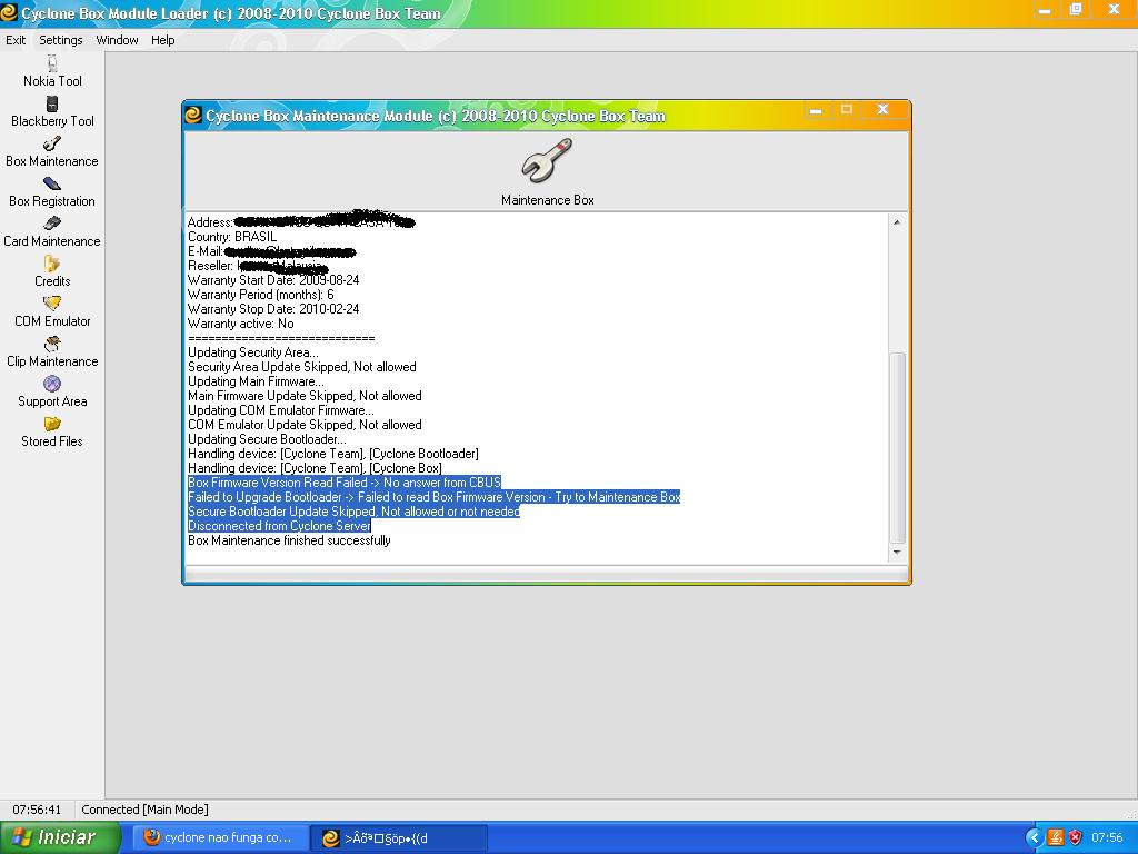

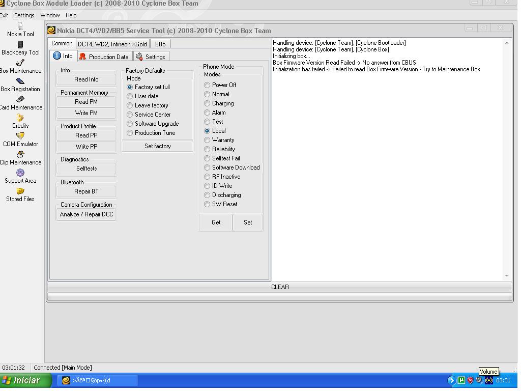

cyclone nao funfa com ultima atualizaçao
ola irmao do clangsm atualizei minha cyclone pra ultima versao so q qndo colo pra ler ela da failed ai desinstalo ela e instalo uma anterior e funciona de boa ela ta ativada super dct4+ foto em anexo ja instalei os driver todos

olha so o q da qndo eu vo fazer atualizaçao no Firmware da box

irmaos resolvi meu problema mi cadastrei no site da cyclone e baixei esse arquivo CycloneBoxuserguide e coloquei dentro da pasta da cyclone e pronto fui em box Maintenance
Box Maintenance procedure started at 19:12:29
Handling device: [Cyclone Team], [Cyclone Box]
Handling device: [Cyclone Team], [Cyclone Bootloader]
Bootloader: Cyclone Secure Bootloader v2.12, (Jul 1 2010 01:06:33), Type: Signed Production Application, Added Clip Support
Service Tag: 465C8260CE7E29E37C300D943B4A2788
Connecting to Cyclone Server
Cyclone Server (1.0.0.650), Cyclone Box Team 2008, 2009, 2010 - Ready.
========= Box Info =========
Box SN: C000177B
HW Revision: A, Suitable for: Production, Case: First Plastic Case, MCU Manufacture Time: 2009, wk19
Set: Box, TX2 Adapter, 100 Credits, 6 Months Warranty
Box registration status: Registered OK
Paired Card SN: D300035B
First Name: EVALDO
Surname: SOARES
Nickname: DADO
Address: RUA MEXICO QD 11 CASA 16
Country: BRASIL
E-Mail: ecellac@hotmail.com
Reseller: Ipmart, Malaysia
Warranty Start Date: 2009-08-24
Warranty Period (months): 6
Warranty Stop Date: 2010-02-24
Warranty active: No
Updating Security Area...
Security Area Updated, Took: 0.125s
Updating Main Firmware...
Main Firmware Updated, Took: 15.531s
Updating COM Emulator Firmware...
COM Emulator Firmware Updated, Took: 1.344s
Updating Secure Bootloader...
Firmware: Cyclone Nokia Application v01.46, (Jul 24 2010 23:54:36, gcc v4.3.2, RTOS V6.0.1), Type: Signed Production Application, © KarwosSoft 2010 wk27
Boot Agent: Cyclone Secure BootAgent Server v3.00 © KarwosSoft 2010 wk25
Cyclone Server Send Command ok -> Code: 500, Not allowed to Upgrade Bootloader
sucesso to Upgrade Bootloader -> Server Transaction Failed
Secure Bootloader Update Skipped, Not allowed or not needed
Disconnected from Cyclone Server
Box Maintenance finished successfully
