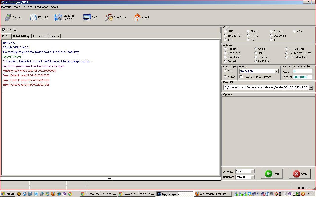

Amigos boa tarde, estou com 3 celulares da marca BAK modelo bk-mp 16wwf, o qual nao consigo fazer leitura na gpgdragon. Ja tentei de varios maneiras, ja tentei varios tipos de boot e ja apertei todas as teclas possiveis, mas só me da o seguinte erro: Initializing... DA_LIB_VER_3.9.0.0 It is sensing the pinout fast,please hold on the phone Power key RXD=6 TXD=8 Connecting...Please hold on the POWER key until the red gauge is going... Any errors please select another boot and try again. Failed to read HardCode, REG=0x80000008 Error: Failed to read REG=0x80010008 Error: Failed to read REG=0x84010008 Error: Failed to read REG=0x80001008 o que devo fazer? qual o procedimento correto? o chip é MTKpost-115814-139967720131_thumb.jpg
Initializing...
DA_LIB_VER_3.9.0.0
RXD=6 TXD=8
o chip é MTK
