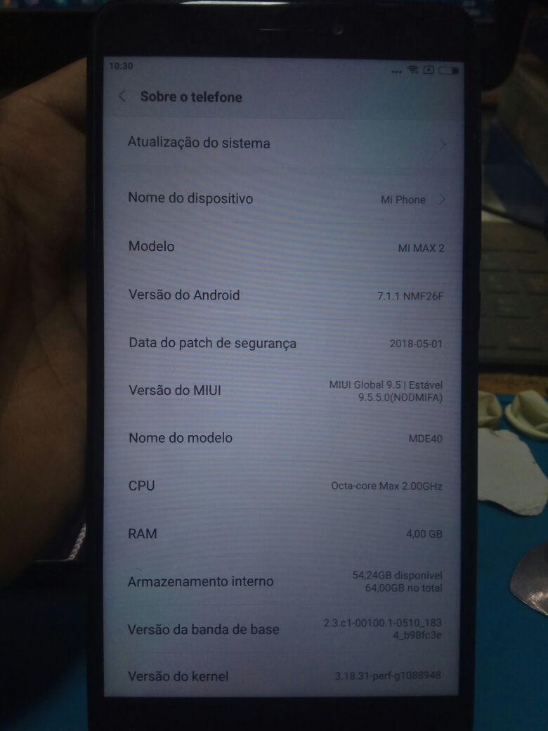

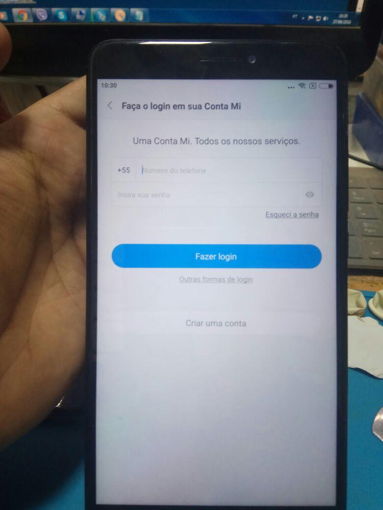

reset conta mi xiaomi mi max 2
Operation    : Reset Mi Account
Checking for existing devices...Not Found
Turn Off phone, hold Vol UP + Vol DOWN and insert USB cable.
Some phones may need Special Boot Cable or TestPoint for EDL mode.
Found Port    : Qualcomm HS-USB QDLoader 9008 (COM8)
Driver Info    : Qualcomm Incorporated, qcusbser.sys, 2.1.2.2
Connecting to phone...OK
Waiting for response...OK
Init Handshake Sequence...OK
Hardware ID    : E1600400 [8953] 00000000
OPK_DATA    : 079E496E26A477B120DFCD85DF7E4AD067164D8292DDD379930D5891E3D8240B
Initializing Protocol...OK
Using Auto Loader Selection [1]
Preparing Firehose Loader...Done
Sending Loader [8953.ufl]...Done
Executing Loader...OK
Detecting Chip Type...OK
Hardware    : 8953, eMMC, 64 GB
LU Count    : 1 [0x0747C000]
WARNING! High Speed Driver is not installed.
Please install driver from QcFire\Drivers folder using Device Manager.
Payload Info    : In: 65536 [4096], Out: 1048576, Sector Size: 512
Reading Partition Table...OK
Reading Device Information...OK
Device    : Xiaomi MI MAX 2 [msm8953]
Software    : NMF26F, V9.5.5.0.NDDMIFA [Thu May 24 22:58:04 CST 2018]
Android Ver.    : 7.1.1
Patch Level    : 2018-05-01
Resetting Mi Account Data...Done
Preparing Data...Done
Formatting Userdata...Done
When phone is completely ON, connect to Internet and add Mi Account.
-------------- INFORMATION --------------
New Firmware may cause hang on logo.
In such case, you need to flash phone to recover.
Or downgrade firmware and try Reset Mi Account again.
Operation Finished.

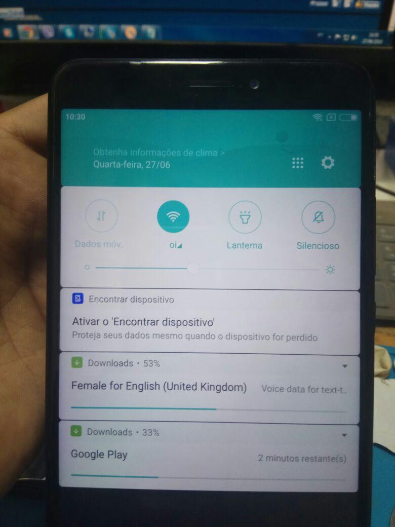

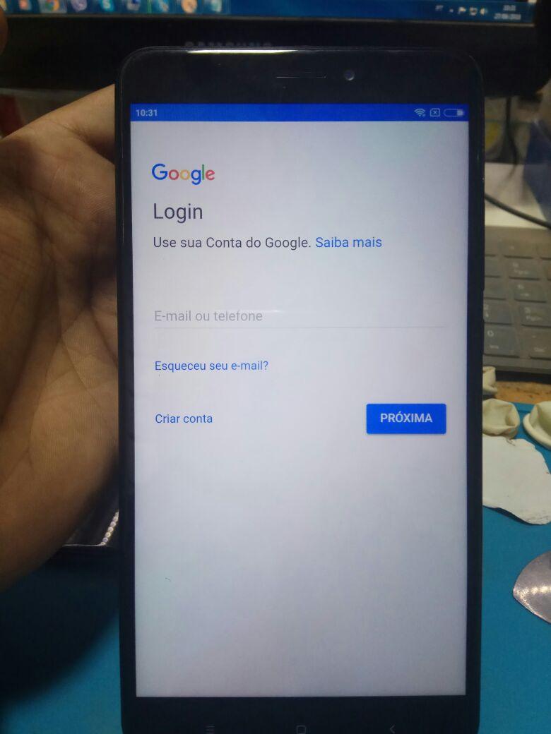

Operation    : Reset FRP
Waiting for response...Ignored
Resetting FRP Lock.......Done
Operation Finished.
