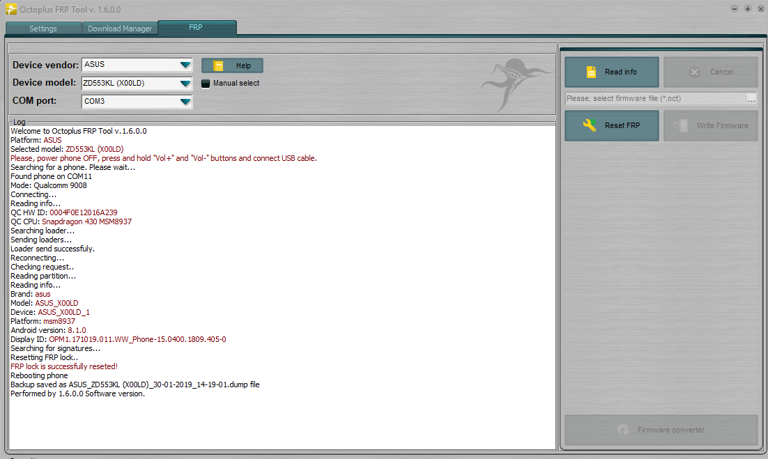

wiko
sunny 3
spd
Platform: WIKO
Selected model: SUNNY 3
Please, reconnect battery, press and hold "Vol+" or "Vol-" button and connect USB cable.
Searching for a phone. Please wait...
Found phone on COM19
Connecting...
Mobile Status: SPRD3
Sending preloader...
Mobile Status: Spreadtrum Boot Block version 1.1
Sending mainloader...
Reading info...
Brand: WIKO
Model: Sunny3
Device: W_K120
Android version: 8.1.0
Custom build version: W_K120-V01.21.OPE.20-[OREO-8.1]-GBL
Internal build version: K120AG_8.1_WIK_ES_22
Display ID: OPM2.171019.012 release-keys
Searching for signatures...
Resetting FRP lock..
FRP lock is successfully reseted!
Backup saved as WIKO_Sunny3_21-06-2019_12-21-22.dump file
Performed by 1.7.4.0 Software version.
