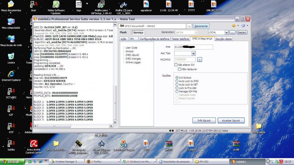

Procedimentos NOKIA realizados com sucesso
unlock nokia 2680 vrs 5.28 com sucesso!
Imei net: 35xxxxxxxxxxxx
Version: SIMLOCK SERVER
Provider: Claro, Country: Brazil
Counter: 0/3, 0/10
CONFIG_DATA: 7240500000000000
PROFILE_BITS: 800000000003000B
BLOCK 1: 1.LOCKED (MCC+MNC): 72405F
PhoneType:RM-392
SwVersion: V 05.28 05-11-08 RM-392 © Nokia
MCU file: rm392__05.28.mcusw
Trying to find patch position ...OK
ASIC ID: 0x3162 [uPP_8M ver: 6.2]
SecondaryBoot: u3_2nd.fia [DCT4] version: 4.79.0 revision: 0.7 size: 0x9D8
Supported Ids: 3040, 2292, 2293, 3162, 3166, 3168
FlashID0: 0020 883C [sT ] page size: 128 K type: NOR area: 01000000-01FFFFFF - COMBO FLASH
ExtBUSC: AD7E B61B 00FF 1040 0000 0000 0000 0000
Algorithm: u3_intel.fia [DCT4 ALGORITHM] version: 4.80.0 revision: 0.7 size: 0x5720
Performing Flash Authentication ...OK
UEM ID: 0041F70C:3B8ADA60
Area [01000000-0101FFFF] erased in 1.141 s
Area [01220000-0123FFFF] erased in 1.125 s
Area [01440000-0145FFFF] erased in 1.141 s
Area [014A0000-014BFFFF] erased in 1.141 s
Area [01CE0000-01CFFFFF] erased in 1.140 s
Programming ...
Programming completed.
Phone not responding !
Area [01220000-0123FFFF] erased in 1.141 s
Area [01440000-0145FFFF] erased in 1.156 s
Area [014A0000-014BFFFF] erased in 1.157 s
Area [01CE0000-01CFFFFF] erased in 1.157 s
Programming ...
Retrying ...
OK, case id: 4
FlashID0: 0020 883C [sT ] page size: 128 K type: NOR area: 01000000-01FFFFFF - COMBO FLASH - COMBO FLASH
Area [01080000-0109FFFF] erased in 1.141 s
Area [01BE0000-01BFFFFF] erased in 1.157 s
Programming ...
Updating SIMLOCK ...OK
Area [01000000-0101FFFF] erased in 1.140 s
Programming ...
Completed in 1 min 57.531 s
Reading Simlock info ...
Provider: ALL Operator, Country: -
Counter: 0/3, 0/10
CONFIG_DATA: 0010100000000000
BLOCK 1: 1.OPEN 2.OPEN 3.OPEN 4.OPEN 5.OPEN
BLOCK 2: 1.OPEN 2.OPEN 3.OPEN 4.OPEN 5.OPEN
BLOCK 3: 1.OPEN 2.OPEN 3.OPEN 4.OPEN 5.OPEN
BLOCK 4: 1.OPEN 2.OPEN 3.OPEN 4.OPEN 5.OPEN
BLOCK 5: 1.OPEN 2.OPEN 3.OPEN 4.OPEN 5.OPEN
BLOCK 6: 1.OPEN 2.OPEN 3.OPEN 4.OPEN 5.OPEN
BLOCK 7: 1.OPEN 2.OPEN 3.OPEN 4.OPEN 5.OPEN

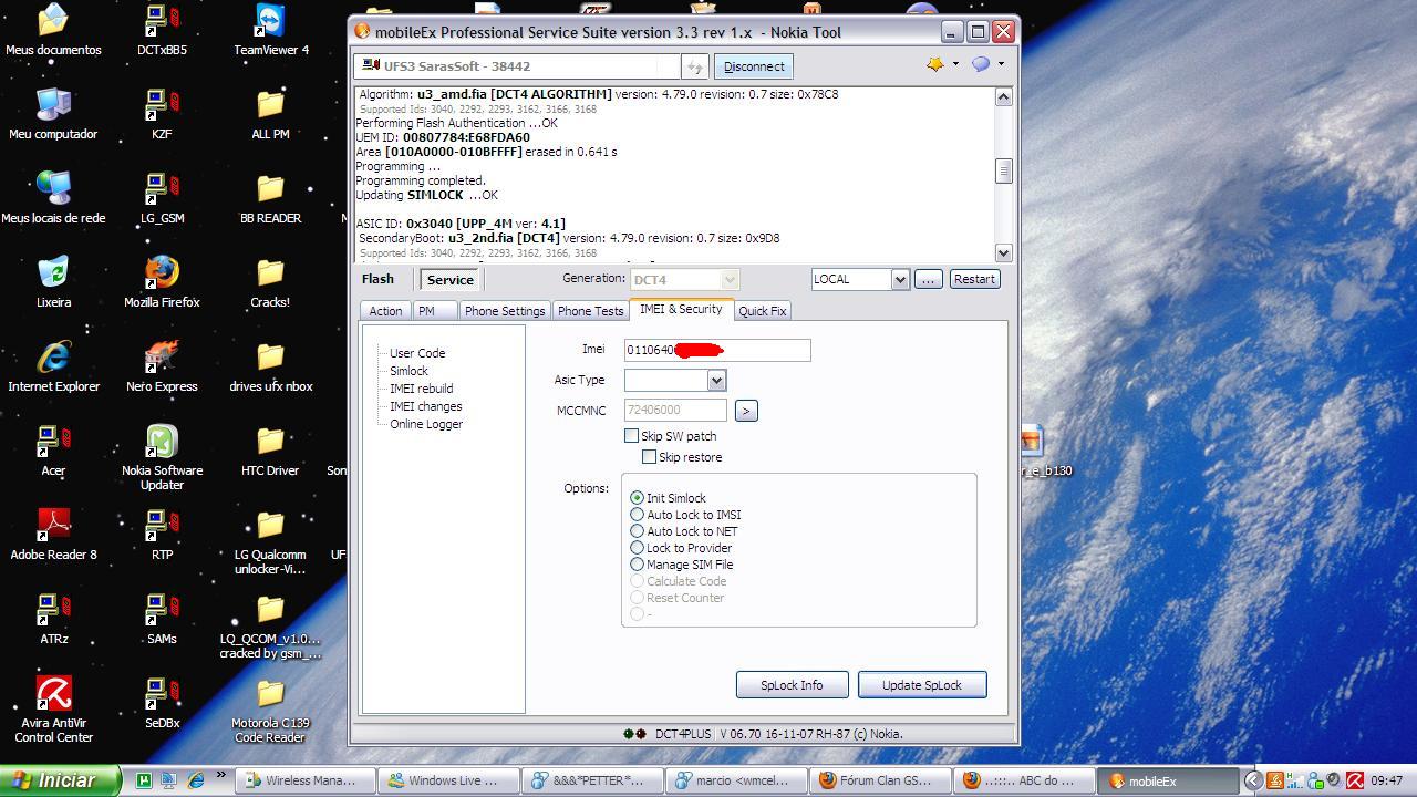

Imei net: 35xxxxxxxxxxxxxxx Version: SIMLOCK SERVER Provider: Claro, Country: Brazil Counter: 0/3, 0/10 CONFIG_DATA: 7240500000000000 PROFILE_BITS: 800000000003000B BLOCK 1: 1.LOCKED (MCC+MNC): 72405F PhoneType:RM-512 SwVersion: V 06.46 23-03-09 RM-512 © Nokia MCU file: rm512__06.46.mcusw Trying to find patch position ...OK ASIC ID: 0x3168 [uPP_8M ver: 6.4] SecondaryBoot: u3_2nd.fia [DCT4] version: 4.79.0 revision: 0.7 size: 0x9D8 Supported Ids: 3040, 2292, 2293, 3162, 3166, 3168 FlashID0: 0089 8981 [intel NU48F256,256 Mbits] page size: 128 K type: NOR area: 01000000-02FFFFFF - COMBO FLASH ExtBUSC: AD7E B61B 2310 0340 C605 E401 20A2 0000 Algorithm: u3_intel.fia [DCT4 ALGORITHM] version: 4.80.0 revision: 0.7 size: 0x5720 Supported Ids: 3040, 2292, 2293, 3162, 3166, 3168 Performing Flash Authentication ...OK UEM ID: 00008341:3B8ADA60 Area [01000000-0101FFFF] erased in 0.922 s Area [01220000-0123FFFF] erased in 0.797 s Area [01440000-0145FFFF] erased in 0.703 s Area [014C0000-014DFFFF] erased in 0.687 s Area [01CE0000-01CFFFFF] erased in 0.047 s Programming ... Programming completed. Updating SIMLOCK ...OK Completed in 1 min 14.907 s Reading Simlock info ... Imei net: 357xxxxxxxxxxxxxx Version: SIMLOCK SERVER Provider: ALL Operator, Country: - Counter: 0/3, 0/10 CONFIG_DATA: 0010100000000000 PROFILE_BITS: 800000000003000B BLOCK 1: 1.OPEN 2.OPEN 3.OPEN 4.OPEN 5.OPEN BLOCK 2: 1.OPEN 2.OPEN 3.OPEN 4.OPEN 5.OPEN BLOCK 3: 1.OPEN 2.OPEN 3.OPEN 4.OPEN 5.OPEN BLOCK 4: 1.OPEN 2.OPEN 3.OPEN 4.OPEN 5.OPEN BLOCK 5: 1.OPEN 2.OPEN 3.OPEN 4.OPEN 5.OPEN BLOCK 6: 1.OPEN 2.OPEN 3.OPEN 4.OPEN 5.OPEN BLOCK 7: 1.OPEN 2.OPEN 3.OPEN 4.OPEN 5.OPEN
unlock nokia 2610
Counter: 0/3, 0/10
CONFIG_DATA: 7240600086388183
PROFILE_BITS: 800000000001000B
BLOCK 1: 1.LOCKED (MCC+MNC): 72406F
BLOCK 2: 1.LOCKED (MCC+MNC): 72410F
BLOCK 3: 1.LOCKED (MCC+MNC): 72411F
BLOCK 4: 1.LOCKED (MCC+MNC): 21407F
BLOCK 5: 1.LOCKED (MCC+MNC): 21402F
BLOCK 6: 1.LOCKED (MCC+MNC): 26806F
PhoneType:RH-87
SwVersion: V 06.70 16-11-07 RH-87 © Nokia.
MCU file: rh86_87__06.70.mcusw
Trying to find patch position ...OK, case id: 2
ASIC ID: 0x3040 [uPP_4M ver: 4.1]
FlashID0: 0001 2C7E [AMD S29NS128N,128 Mbits] page size: 128 K type: NOR area: 01000000-01FFFFFF
FlashID1: 0000 0001 [unused/removed]
ExtBUSC: AD7E B61A 1BBE 0BE2 7D58 6BE4 DBEE 6514
Algorithm: u3_amd.fia [DCT4 ALGORITHM] version: 4.79.0 revision: 0.7 size: 0x78C8
UEM ID: 00807784:E68FDA60
Area [010A0000-010BFFFF] erased in 0.641 s
Programming ...
Area [010A0000-010BFFFF] erased in 0.672 s
Programming ...
Completed in 44.359 s
Imei net: 01106400519243
Version: SIMLOCK SERVER VERSION 63
Counter: 0/3, 0/10
