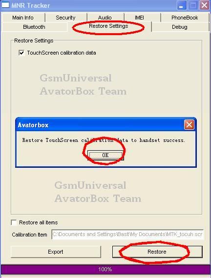

Como calibrar o Touch Screen com o Software AvatorBox
Posted Image
Posted Image
Faça o download no Suporte -> Utilities -> Download_MTK_touch screen calibration.rar
Vá em Tracker -> Touch Calibration -> Restaure com esse arquivo
Best Regards
AvatorBox Team
