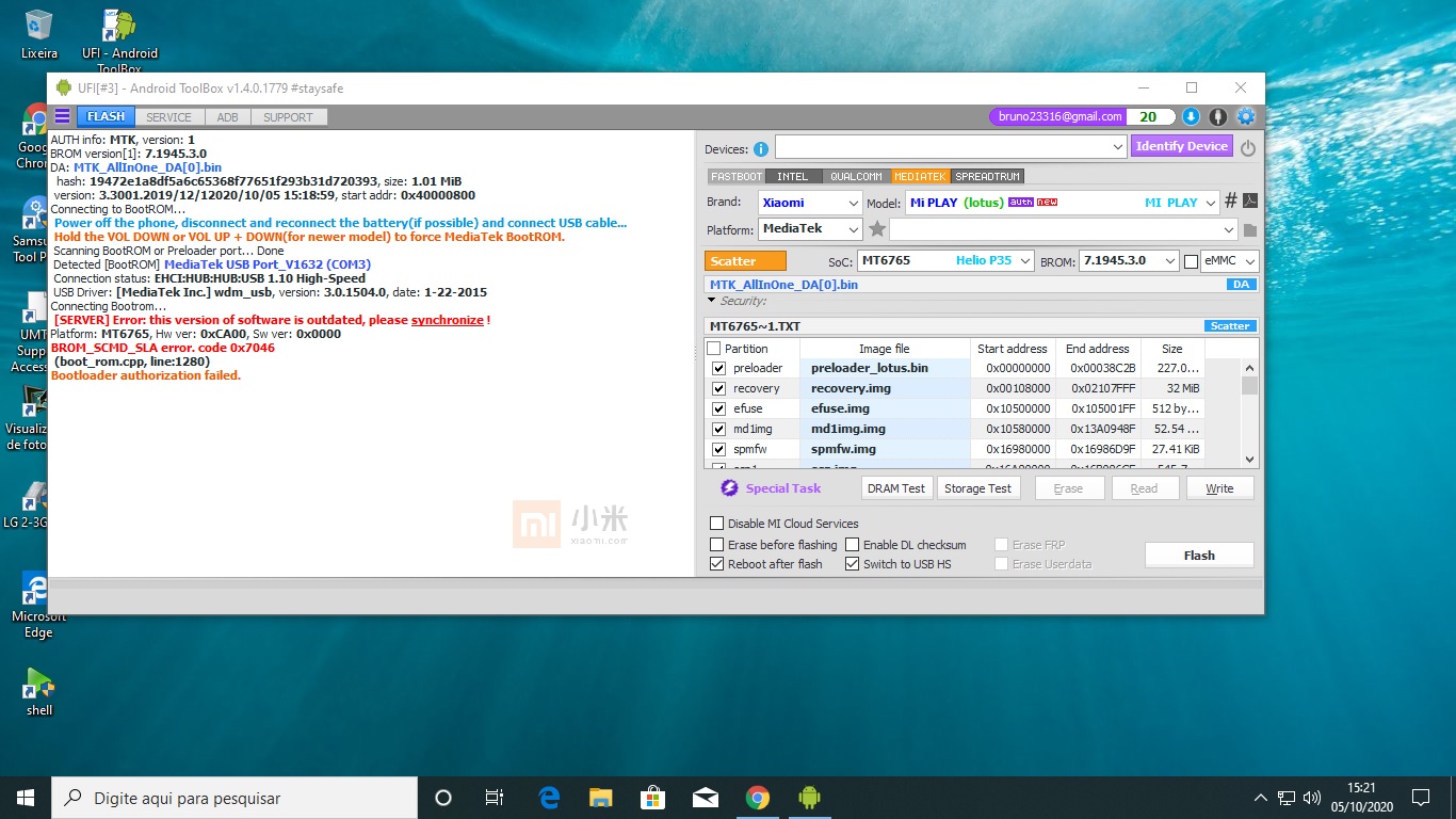

Postado Outubro 5, 2020 5 anos alguem que tem a ufi para da uma ajuda aqui estou tentando a dias fazer flash no mi play estava dando servidor ocupado ai meu pc deu problema e tive que formata agora do este erro AUTH info: MTK, version: 1 BROM version[1]: 7.1945.3.0 DA: MTK_AllInOne_DA[0].bin hash: 19472e1a8df5a6c65368f77651f293b31d720393, size: 1.01 MiB version: 3.3001.2019/12/12020/10/05 16:16:35, start addr: 0x40000800 Connecting to BootROM... Power off the phone, disconnect and reconnect the battery(if possible) and connect USB cable... Hold the VOL DOWN or VOL UP + DOWN(for newer model) to force MediaTek BootROM. Scanning BootROM or Preloader port... Done Detected [BootROM] MediaTek USB Port_V1632 (COM3) Connection status: EHCI:HUB:HUB:USB 1.10 High-Speed USB Driver: [MediaTek Inc.] wdm_usb, version: 3.0.1504.0, date: 1-22-2015 Connecting Bootrom... [SERVER] Error: this version of software is outdated, please synchronize ! Platform: MT6765, Hw ver: 0xCA00, Sw ver: 0x0000 BROM_SCMD_SLA error. code 0x7046 (boot_rom.cpp, line:1280) Bootloader authorization failed. OK updating file: app/db/emmc.db (53 KiB)... OK updating file: app/db.def (1.98 MiB)...
Postado Outubro 5, 2020 5 anos Autor AUTH info: MTK, version: 1 BROM version[1]: 7.1922.6.0 DA: MTK_AllInOne_DA[1].bin hash: 29541b6af15c397977fb6c85df452c0add11ca18, size: 1.01 MiB version: 3.3001.2019/06/02020/10/05 16:51:41, start addr: 0x40000800 Connecting to BootROM... Power off the phone, disconnect and reconnect the battery(if possible) and connect USB cable... Hold the VOL DOWN or VOL UP + DOWN(for newer model) to force MediaTek BootROM. Scanning BootROM or Preloader port... Done Detected [BootROM] MediaTek USB Port_V1632 (COM3) Connection status: EHCI:HUB:HUB:USB 1.10 High-Speed USB Driver: [MediaTek Inc.] wdm_usb, version: 3.0.1504.0, date: 1-22-2015 Connecting Bootrom... Requesting flash signature from server... [SERVER] Sorry, We have run out of all available slots, please try again in 13 minutes. Platform: MT6765, Hw ver: 0xCA00, Sw ver: 0x0000 BROM_SCMD_SLA error. code 0x7046 (boot_rom.cpp, line:1280) Bootloader authorization failed. a dias tento mas sempre ocupado o servidor
